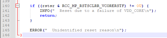

由 Reset reason (0x10)
找到:Buildroot_2020.02.x/output/build/arm-trusted-firmware-origin_stm32mp-ya15xc/plat/st/stm32mp1/bl2_plat_setup.c 文件;
由 RCC_MP_RSTSCLRR_VCORERSTF 找到:

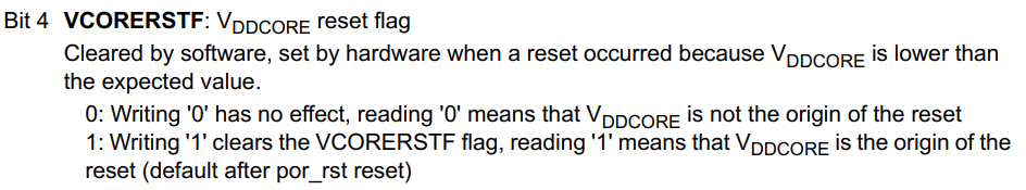

Buildroot_2020.02.x/output/build/arm-trusted-firmware-origin_stm32mp-ya15xc/include/drivers/st/stm32mp1_rcc.h 文件:
由 RCC_MP_RSTSCLRR 找到 DM00327659_NEW.pdf (芯片手册中的)
芯片手册说 V_DDCORE 未达预期,硬件置位;
推测,供电异常?硬件有问题?还是软件相关电压没配置对?
