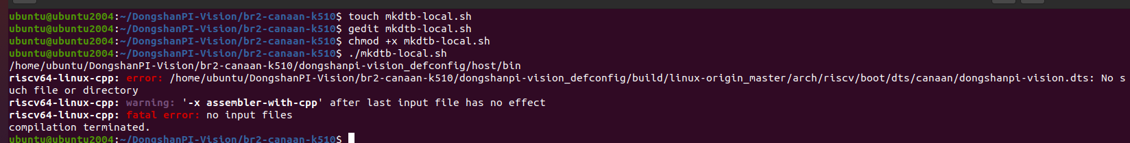

问题现象:
解决办法:
将
DongshanPI-Vision/br2-canaan-k510/dongshanpi-vision_defconfig/build/linux-origin_master/arch/riscv/boot/dts/canaan
目录下的k510_crb_lp3_v1_2.dts拷贝为 dongshanpi-vision.dts
即执行如下命令:
ubuntu@ubuntu2004:~/DongshanPI-Vision/br2-canaan-k510/dongshanpi-vision_defconfig/build/linux-origin_master/arch/riscv/boot/dts/canaan$ cp k510_crb_lp3_v1_2.dts dongshanpi-vision.dts
